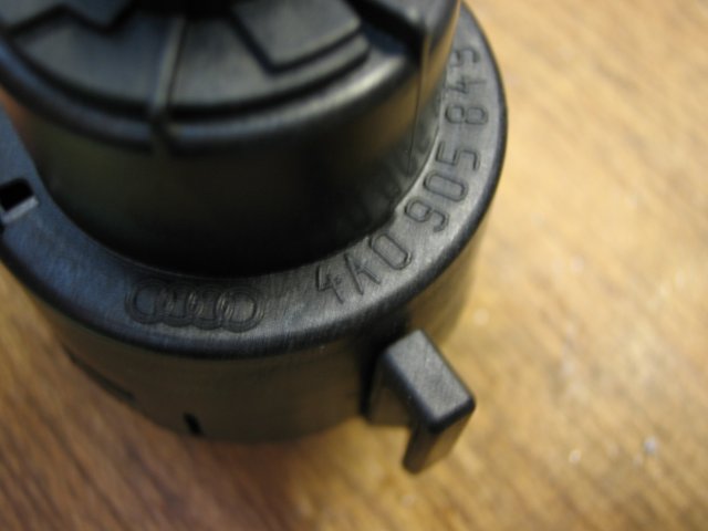

a quick tinternet search and Ive ordered the part, its an audi/vw part and becker manufacture coming from parts supplyer in Birmingaham at an all in price delivered of the princly sum of £7.80 total.
Seems criminal not to get it and put it on - for sure it will definately eliminate the switch as a problem.

part arrived post and packing for just £7.80 - Ebay.
Fitted it saturday mornunning OK in about 35 mins, all up and running with no problems to report.

You have to be a bit carerful with buying them from eBay. The original part was made by Hella, and even though they fail too frequently, the quality of some eBay items is far worse. If you have one embossed with the VW part number you will be fine.
