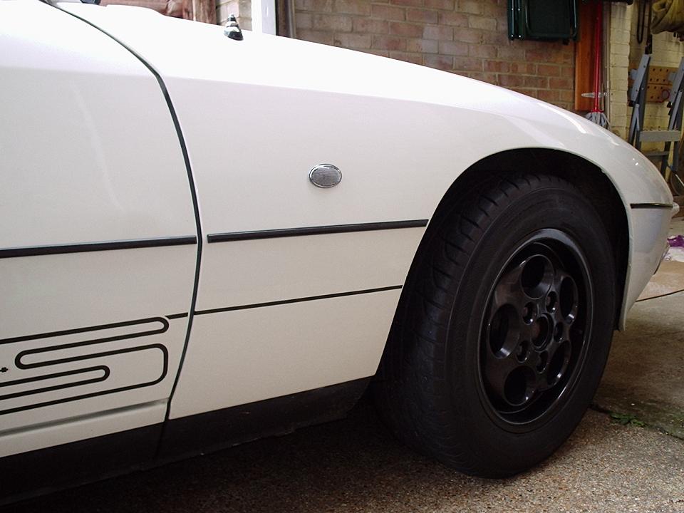

The wheels are 7" teledials (off a 944S), painted Graphite Grey (very dark). A recent fitting - here's a better pic, with a couple more to follow...

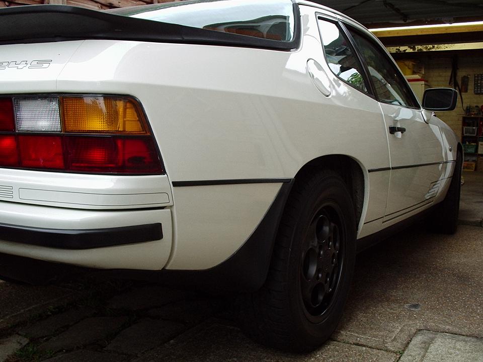

and another one. (I've fitted the centre cap to the front ones since taking that last picture)

Hey Phil, I like the wheels [:)]
Re the wipers. when I had problems with mine I pulled the relay so now I have no intermittent and no park for the wipers, but I do have full control!
Re the wheels. Did you have to change the spacers to get the 944 wheels in, I thought the offsets were different (944 vs 924S) Nice job though~!
Obviously the shame of being mentioned on the forum did the trick, as I took the car out yesterday and they're working fine [:)]
The wheels went straight on. They are 7x15 ET52.3 and they're fine as they are. I thought the fronts might be a problem as the original Goodyear Eagle 195/65's came right out to the wheelarches, but these tyres (Yokohama A520 205/60x15) aren't much wider. They have a much squarer shoulder which actually looks and sits a lot better. Handling feels great.
