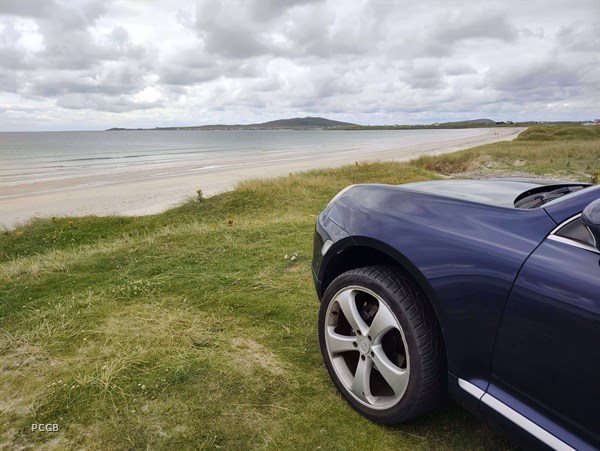

I drove it from Home to Oban yesterday - all very comfortable quick stop in Winchester for a tank of Shells finest and water for me then Just SW of Glasgow a refill of the fuel tank and a McDonalds for me. On to Oban where despite the heavy load on board it was enjoyable from Loch lomond North through the twisties and the roads were really quite as I didn't leave home until after 2 so it was midnight by arrival, got out feeling pretty fresh.
Ferry to Tiree this morning - was slightly embarrased to spot and get excited by the view of Balamory (Tobermory) from the ferry!
Really could do with smaller wheels / more rubber on the roads here but at least I will have plenty of opportunity to pinpoint the cabin rattles. Cllimbed the grassy back of a sand dune today so was able to exercise low ratio on the decent - didn't need it but good to know it does work and give the actuator some exercise :)
Found some of the drains, one was blocked and had some water in it but there are more hiding somewhere!

and a photo
Sadly most of the houses do not have grass roofs anymore - many making the new roof taller to accommodate more living space - was interesting to find out the grass roofs were shaped to suit the prevailing wind, creating some rudimentary downforce.
