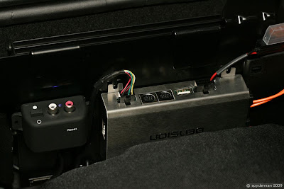

I've just yesterday had a Dension 500 fitted to my 2004 S by fellow forum member Berty987. He's done a couple of them before, so I thought I'd let an expert do it for me. I bought it used via a different forum - new, they're quite expensive. My car has PCM 2.1 with the CDC-4 6-disc changer. We peered the power off the CDC's supply (it doesn't use much current) and configured the fibre optic "cable" to put the Dension in series with the CDC. We then mounted the Dension itself using sticky pads to the front of the bracket that holds the power amplifier.
Installation is a little easier in the 986 than the 987 as there is more room and the bits are visible rather than hidden under plastic panels.
I am using a USB stick with it (MP3 files only), but I could also use my iPod Touch (which would allow the playback of copy-protected AAC tracks too).
The above photo shows (from left) switch to change from CDC to Dension, aux line-level input, connector for this switch, iPod interface(s), USB socket, power connector, in-line fuse. The orange "cables" are the fibre optics for the MOST buss.
A few more photos in this gallery.
