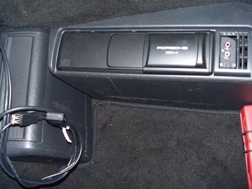

the Denison unit will fit behind the CD changer. Two spacer washers are required to move the passenger side CD mounting out by about 3mm. This does not affect the CD changer plastic casing, which still fits fine. The Gateway 500 Aux/Selector unit fits on the side of the CD changer, the changer casing vent has been cut away to give access to it. See attached picture.
