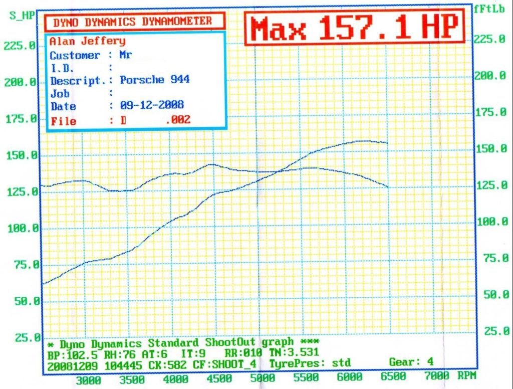

Thanks for the replies folks, I suspect I am worrying over nothing but thats just me, anyway it gives me something to think about. Managed to dig out RR readout from a few months ago which shows the shortfall in torque and BHP.

Again, looking at the torque curve, it is way down. If I read the grid properly you are showing 143lb/ft at 4450 rpm, whereas factory fresh it should be 170lb/ft at 4300, so no wonder you are embarrassed by 1.6 TDIs. At 10.9:1, which I have just looked up, you should see nearly 11 times atmospheric so think 165psi not 120.

Well, the reference to 1.6D Escorts was a little tongue in cheek, but yes you are correct with your reading of the graph. Now I dont expect anywhere near 'factory fresh' values, but if I can find a way to get it to within reasonable figures I will be happy.
