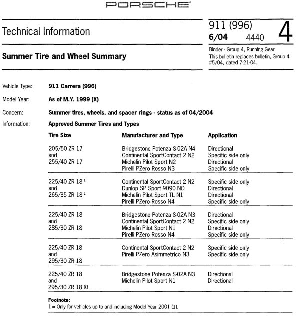

Here is an extract from the Porsche TSB:
205/50 ZR 17 and 255/40 ZR 17
Bridgestone Potenza S-02A N4 Directional
Continental SportContact 2 N2 Specific side only
Michelin Pilot Sport N2 Directional
Pirelli PZero Rosso N3 Specific side only
225/40 ZR 18 (1) and 265/35 ZR 18 (1)
Dunlop SP Sport 9090 NO Directional
Michelin Pilot Sport TL Nl Directional
Pirelli PZero Rosso N4 Specific side only
225/40 ZR 18 and 285/30 ZR 18
Bridgestone Potenza S-02A N3 Directional
Michelin Pilot Sport Nl Directional
225/40 ZR 18 and 295/30 ZR 18
Pirelli PZero Asimmetrico N3 Specific side only
225/40 ZR 18 and 295/30 ZR 18 XL
Footnote:
(1) = Only for vehicles up to and including Model Year 2001 (1).

My understanding is that theoretically you should not mix tyres of different N ratings, any more than you should mix different patterns from the same manufacturer. Imagine my surprise when I found that my rear tyres 295/30/18 are available as Rosso's rated N5, but Pirelli have no N5 rated Rosso's for the fronts (225/40/18). It would seem that the only way I could achieve a full set of Pirellis with matching N ratings was to go for PZero System Assimetrico rather than Rosso. I have ended up going for the Bridgestone SO2 N3's all round
You certainly shouldn't mix different N ratings or N-rated and non-N-rated tyres on the same axel but I think it's good and safe practice to have a matched axel-set of tyres anyway. I'm not 100% sure on mixing different N rating between the front and rear axels though, i've read mixed reviews on this.
