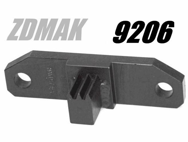

Is this what the Porsche flywheel lock tool looks like?
morris944s2john
If so has anyone got dimensions, i'm considering making one.
No not for a 944. It looks like this. Take the starter motor off and measure the hole centres and the distance from the face to the flywheel ring gear. Cant remember the measurements offhand and the lock is out on loan but if you're thinking of making one then you can make one. A drill. stick welder and angle grinder with a slitting disc and you're in buisiness[:)]
Thanks! I have all that and more (drill, access to drill press, Mig welder, angle grinders, steel etc).
I am going to make me one of those.
