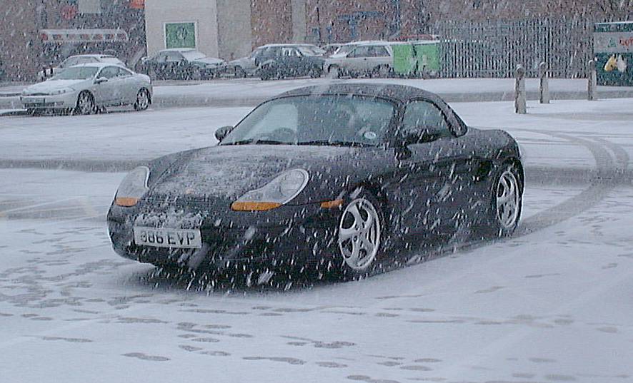

Last time it was snowing in my area, I was trying to make it up a fairly steep hill in my 986 2.5 and I was all over the shop, a 20yr old Fiat Panda overtook me, and I just couldn't look at the driver, he must have had a good laugh [:D]
