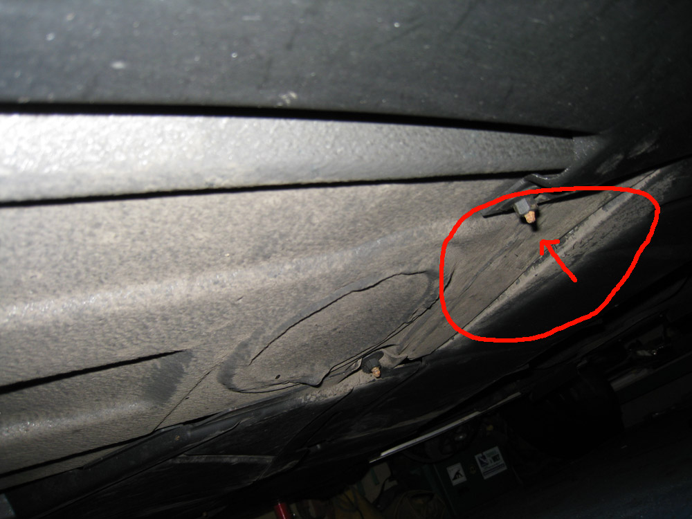

I managed to get a couple of photos of the damage this evening as I was in the process of changing the control arms.
The area in question is in the red circle. The arrow is where the jack was placed and where the damage occured. You can see how this area is no longer parallel to the area just behind it.
That looks like to boot floor, if so will not be structural and you may be able to knock out from inside. I would put some paint/protection where the paint looks damaged.
