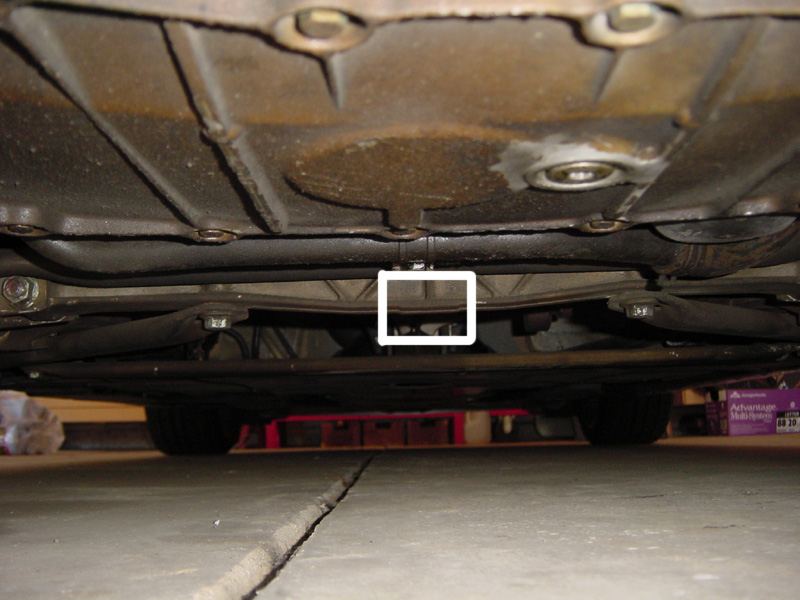

I jacked up the car with the trolley jack under the suspension lower arms and then placed the axle stand (with a piece of wood between) at the usual jacking points.
I didn't do all 4 corners at once - I did the rears then the fronts, I felt this would be more stable. I did seriously chock the set of wheels that were on the ground though.
I had quite lowered suspension and to get the trolley jack underneath the car at the lower arms I drove the car up onto some pieces of wood to give me a couple of extra inches room, this may not be necessary with standard height depending how 'slimline' your trolley jack is.
There's probably a more recommended way and I guess someone will suggest something else.

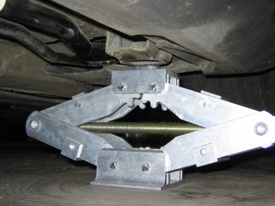

Just under the sills - just behind the front wheel, and just in front of the back wheel - you'll see the jacking points, with an oval hole for the lug on the standard jack.
You'll need a low entry jack, and (ideally) use a jack pad or hockey puck. Be extra careful on the driver's side, as the aircon pipes run very close to the jacking points, and it is all too easy to damage them.
In normal operation they should be jacked with pads to prevent damage. When taken to tyre shops or 'non-porsche' garages then it's not uncommon for pads not being used and hence damage occurs. The protective underseal gets damaged and then corrosion sets in. Mine had damage to the air-con pipes running along the drivers side. If the jack point has collapsed, then I guess it will take some work to get this repaired. I would check no corrosion has caused this on the chassis. I would then seal any corrosion before winter sets in.
I purchased some pads from a well known bidding site, but any Porsche specialist should sell them.
