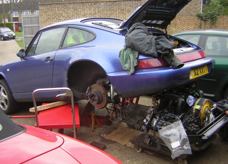

See the picture ...if you take the bumper off you need less height ..I left it on .
I used a large hydraulic table, a scissor hydraulic jack, a trolley jack and then a timber beam to give me the leverage and height. Make sure the front wheels are chocked.
Be carefully though its quite heavy !!!
Im doing a top end rebuild at the moment. I had the car almost level with torsion bars approx 800mm high, removed bumper because of engine bogi (made so the jack can slide from under it) also had jack under trans. Did it on my own all went smoothly, just take your time and have all the books to hand & take photos.
Ian, that picture of your dropped engine has prompted me to ask a question. Do you think it would be possible to lower the engine a small amount (not a complete drop) to enable the rear most heat shield (bumper side of the engine carrier) to be changed?
Good question .
I need to replace my one in time..when I buy a new shield at over £250!!!
Doing the metal door frames at the moment so these are all off ....
I think ..
1) Remover the rear exhaust box
2) Drop the rear of the engine on the two rear mounts
this should then give you access to the shield.....
But I have not done this yet ..... with the engine in .
