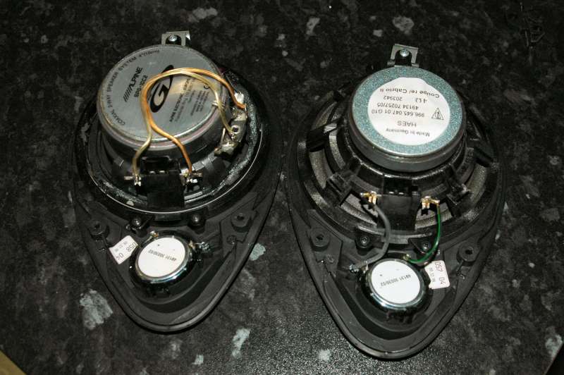

Some words of explanation to the pics:

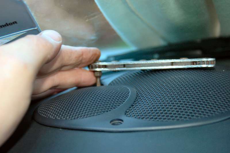

First picture shows the torx bit in a small ratchet spanner used to remove the front speaker units.

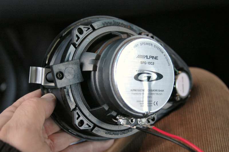

Picture 2 shows the finished modified Alpine speaker installed in the OEM speaker baskets that can be seen in Photo 3. The OEM Nokia unit is shown as comparison on the right.
These modded OEM speaker baskets with the Alpines bonded in place require only an additional jumper wires (visiblke in the pic) to be soldered from the OEM speaker socket to the speakers and have been used in the rear side panels.

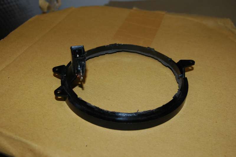

Picture 4 shows the Alpine fitted using the JMG adapter ring, the kit comes with correct cables and plugs to use the OEM speaker plugs and was installed in the front before I discovered I could use the original speaker basket and modify with a dremel to accept the Alpines....
