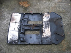

I find it hard to believe that anyone can say they've inspected a 964 without taking the under-tray off. This is most definitely a requirement before any decision can be made. What are they doing charging for an inspection without it?????
Thanks for the advice. When I spoke ot the OPC about the inspection they were able to confirm that the undertray was removed and that their were no obvious oil leaks. In addition the technician was able to confirm that the inspection was carried out by one of the team who had routinely serviced the 964's in the past, and commented that car was much better than the many of the 964's serveiced or inspected by them in the past, and that not all OPC were happy to service the series due to lack of proficient technicians (particularly in London)
From my limited experience I can confirm that on one of the previous cars I had arranged for a PPI on the undertray couldn't be removed due to rounded heads. Nevertheless, the inspector did a thorough job and was able to demonstrate obvious signs of leaks.
Obviously, I'd of rather had Peter Morgan look at the car, but it wasn't possible, so hence the OPC. It's easy to take their commenst with a pinch of salt, but compared to what I've seen of some other cars I think its OK.
