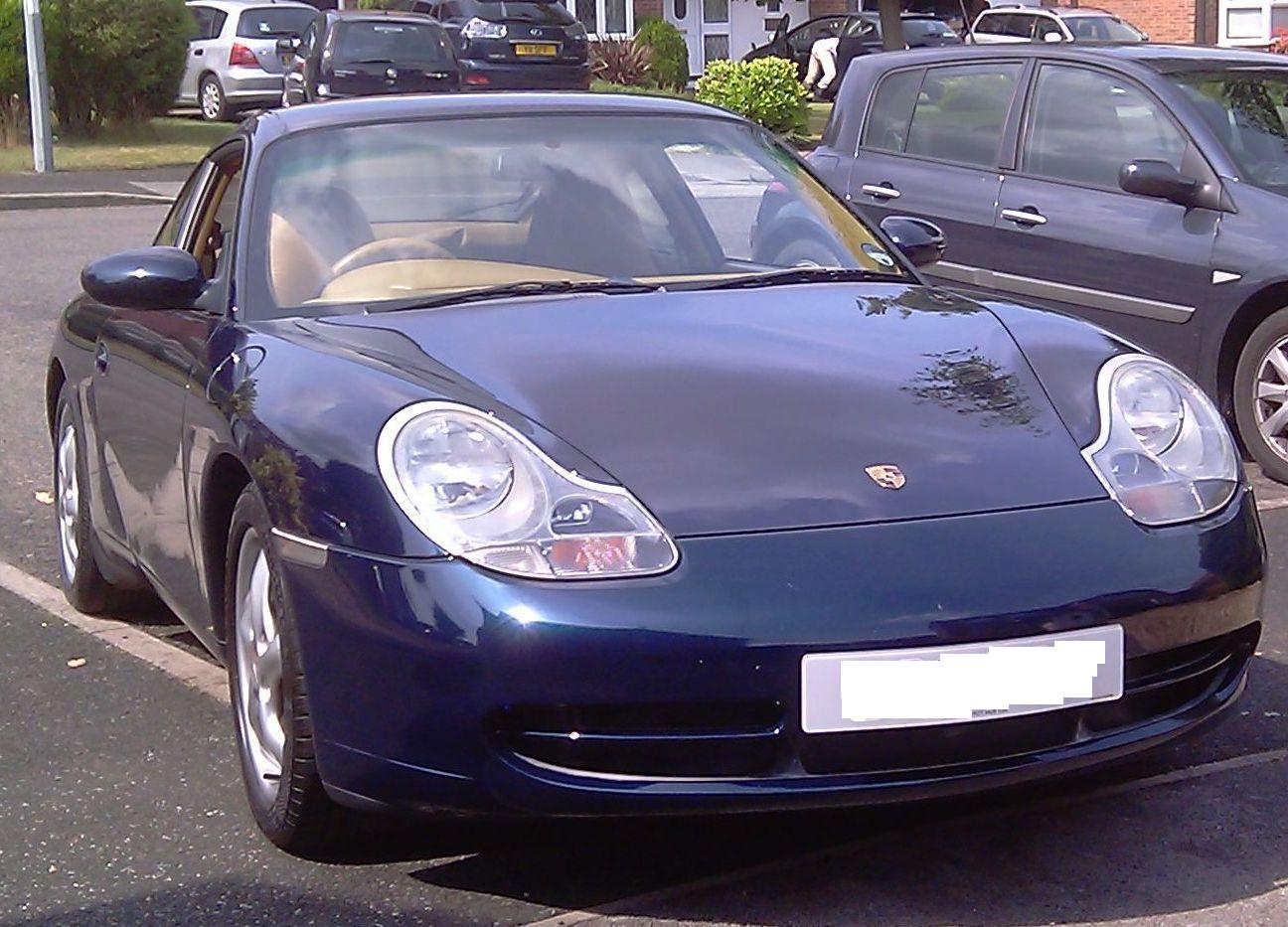

P.s.
Heres a pic
Hi, welcome to the 996. Tyre pressures as stated in the drivers manual and are a good starting point, you may find that there are some differences from other peoples experience on what works for them. I have had a number of Porsches and recently got a 996 C4S. There is no Haynes manuals for these cars although you can find some iformation on the net regarding this and a lot of help can be found on the forum, its a good source of information and help , you need to find a good independant Porsche garage locally, again people on the forum can advise of those in your area. You should check all the uausal things as usual oil, water & tyre pressures etc. You do not need a couple of bags of sand in the front as these cars handle very well provided the geometry is to specification and everything is as it should be. Seems an odd mixture of tyres and you would not normally mix tyre makes either on an axle or back and front. Both tyre types are acceptable provided they are "N" rated (its marked on the tyre after the tyre size). There should not be water under the car in the position you mention perhaps theres a leaking pipe or its running down the undershield from somewhere else rads etc, check the water level in the engine bay its the blue cap job on the left in the back corner, its clearly marked as to where the level is. Did you purchase from a dealer with a warranty or not it might be worth getting it checked anyway. Hope you resolve you issues[8D] Brad
Chris! Nice clour combo - same as my C2. Not as fast as silver, of course! I think the water dripping from that area is typical air conditioning condensate. If it is clear plain water, don't worry about it. Edit: Take a look at www.cannell.co.uk/Manuals.htm . A bit out of date, but it covers the pre-facelift, and is a lot better than a Haynes manual.
