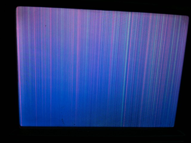

Main one is the lines on the screen.. obviously I have no music, no sat nav and no phone...
below is a picture of the lines on the screen so you can see what im talking about...
Also, as it is a cat D there is no paperwork with the car, I have traced when and where it was serviced so will go about getting a replacement service book stamped up, But even when my screen is sorted, I will have no code for it.. How much of an issue is this, can I get it from Porsche or should I just give up and buy a new screen unit? I see guys on ebay advertising for £150 just to decode these head units and they all claim that the units are very difficult to do????? Any truth there?

PCM - It depends when in 2002 the car was built. If after 1st September it will be PCM2, and there are no security codes to enter. The unit is matched to the DME, so when you disconnect and re-connect the battery, it automatically pairs itself. If prior to September, then it is PCM1 and has user-entry codes. You can get them from Porsche, or if you know someone with a Porsche tester, they are often stored in the DME vehicle data, and can be read out by the tester. It won't be the code causing the lines though.

The car is booked into OPC on wednesday for a check over, Having a new key fob programmed at the same time and was told they will run the tester on the car to see if there are any errors showing, of if any in the past.
Am i right in assuming then that if the PCM needs a code it could be read at the same time?
While they have the PIWIS tester connected, ask them to read the Vehicle Data from the DME, to see if the navigation codes are stored. If not, the OPC will be able to get them for you, but they usually ask you for a copy of the V5C as proof of ownership. I expect they asked you for this for the key programming, and they will get the PCM codes at the same time if you ask them.

PCM not working- got a good 2nd hand one with code card for £400
