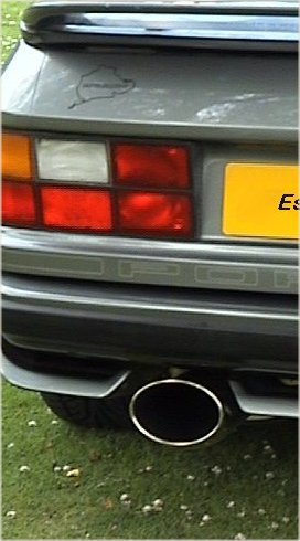

A little pic of mine, just so the others know what we are on about
Tony

Totally disuaded thanks John but...
then Tony goes and posts a picture and gives me an inferiority complex [;)]
God help me if Slim posts a sound file [:D]
