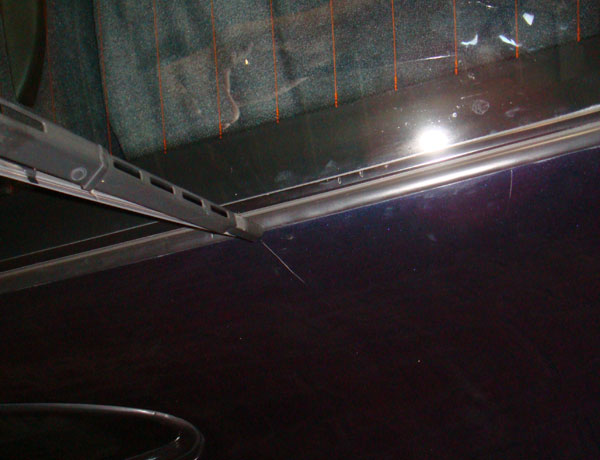

It's a new record for me, I've had my latest 996 for 6 days and it's already been keyed by some jealous cretin.
The car was scratch free and looked fantastic when I picked it up. It's been garaged since I got it home and has only been parked up for 5 minutes outside the bank in my local town, I'm 99% sure this is where it happened, there was a guy unloading a van 10 metres or so behind the space where I parked and he's so far the prime suspect [:mad:]
Anyway, the passenger side door has a nice new scratch and the rear panel next to the window has a rather nasty one. I'm pretty sure the scratch in the door can be easily polished out but the one in the picture is quite deep - what do you guys reckon, will that need a respray? Can anyone recommend anyone in the Surrey/SW London area to do it?

Hi Gavin. You have my sympathy, some people are pathetic. Is the deep scratch on the near-side rear windscreen pillar? It looks like it might be. If so (this is only a thought) are you sure that this wasn't caused by the end of the rear wiper dropping onto the pillar at some point - and maybe you hadn't noticed it before? I know it's a long shot but this happened to me and the first thing I thought was that it had been keyed, whereas in actual fact it was me who caused it while washing the car. What have all the other marks in the window rubber been caused by? If it is the rear windscreen pillar then this is a classic 996 thing to look out for - they have changed the rear wiper on the 997 to an all rubber one now!
Anyway, it looks like you'll have to have the lacquer striped off the rear wing and the near-side front and back windscreen pillars and outer roof section. They'll probably only use a bit of colour where the scratch is. I've had a quote to get mine done at my local Porsche approved repair place (S.Wales) and they quoted me £300 + VAT. My car is in Seal Grey and it doesn't show up that much so I've left it alone - I might get it done before I sell it.

Thanks for replying Adrian.
That's exactly where the scratch is, it actually loops round and meets the window again so could very well have been caused by the wiper. I'll have another look at it tomorrow and see if this might have been the cause. If it is then I must have missed it when I picked the car up, no doubt too keen to get driving to have noticed it.

Hi Gavin. I hope that it is the wiper - try lifting it up and letting it down with the wiper turned at 90 degrees to the wiper arm and see if it could have physically caused the scratch - do this VERY carefully!! The best part about this is that (maybe) it wasn't done maliciously - OPC did the first one for me, then I did the other one to make a pair! All the best. Let us know how you get on. Adrian.

Sounds just like the rear wiper right down to the shape of the scratch. So (a) it was self inflicted and (b) it aint cheap to fix (properly). Believe me, I've been through your pain!! I was fuming for days. NEVER leave the rear wiper in the 'up' position during washing. ALWAYS lift and hold while you wash under it.
I had a quote from a porsche approved body shop and it was £7-800 I seem to remember. Windows out and all that stuff. In the end I compromised and they did their best to polish it out. The pain subsides with time ;-) I think you will find ChipsAway dont profess to like working on premium cars such as ours.

It looks like I was wrong and the damage was caused by the rear wiper, apologies to the white van man!
The annoying thing is that I haven't touched the wiper since I picked the car up last Thursday and it wasn't there when I had a good look over the car before I agreed to buy it. It looks like it happended during the pre-collection wash.
I've attached another picture with me holding the wiper above the scratch, looks pretty conclusive.
Hopefully it can be sorted without a panel respray.
Gavin

Looking at the pictures is it the kind of thing chipsaway could sort out?

I did this to mine a few weeks ago when washing it. A really deep scratch, and I was spitting feathers. I've improved it dramatically with some touch-up and some Langka, but it needs professional attention really. The ironic thing was, at the time I was lecturing my 5 yr old daughter who was helping me wash the car on the importance of using the second bucket for rinsing the sponge before washing again!
Me too! Leaving the rear wiper up is asking for trouble - the nice deep scratch in mine is testament to that!
