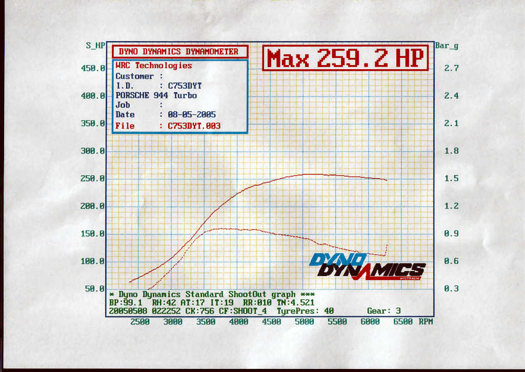

The graph below shows the boost level for Phil Kents car at last years Dyno Day. His has a 26/6 but uses the standard wastegate with a boost enhancer. Max boost was just over 0.9 bar at 3600rpm but has dropped to 0.6 bar by the redline.

It's interesting to note that 0.1 bar of boost on a mainly standard engine is worth around 23 ish bhp as my car is running at 0.8 bar boost and gets 237.5bhp while Phil Kents car is getting 259.2bhp at 0.9 bar.
