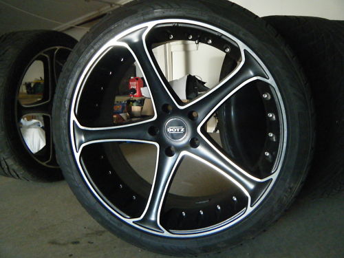

No wheels on order. I will just keep hunting ebay till I find a set. There was a cracking set on beay but they guy never responded to any of my questions so was to sacrd to bid, pity as they look real cool.
Got a towbar as well today. It is off a Touareg but from what i have read they are all the same. Hope so[]
Plus, my mate had them on his RX8 and they buckled very easily, very soft alloy and with being 22 inch wheels and the state of the roads in Glasgow, I thought better of it....

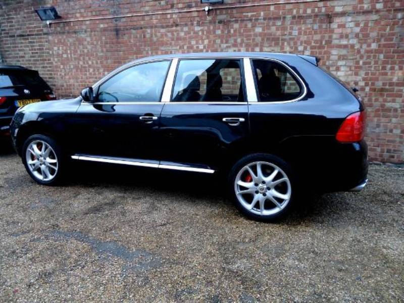

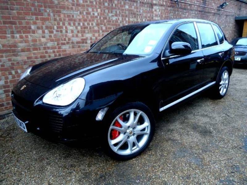

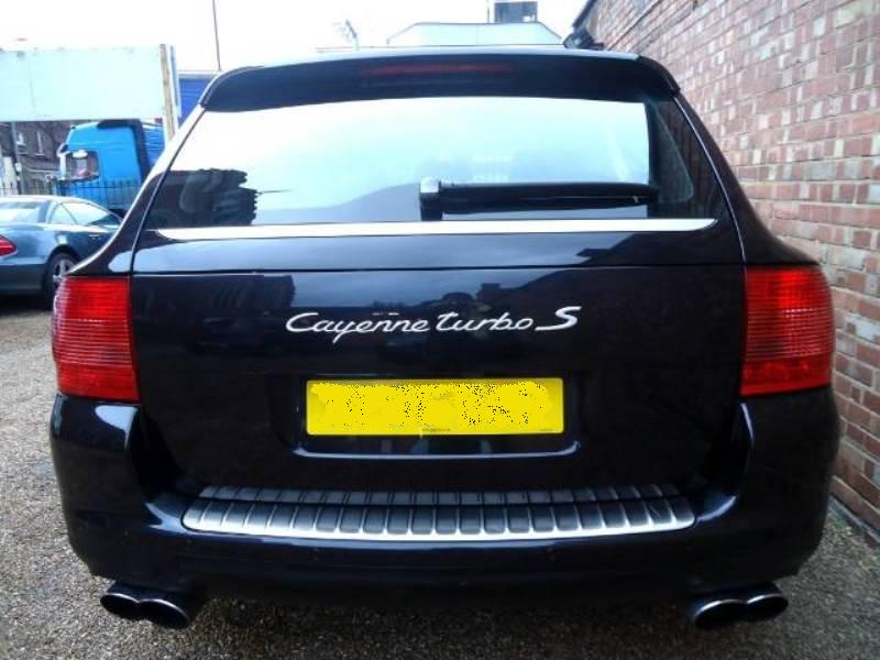

Good luck in getting it sorted and look forward to photo's once it's finished...[]
