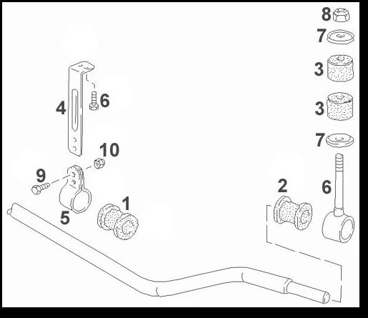

hiya all, whilst driving today noticed that every now and again when slowing down, i am getting a slight clunk/knock on what feels like front left side near wheel,did tyre pressures before my journey, car driving great, all gauge readings are perfect, any ideas what this might be? thanks and regards as always... jason p ps no noise when breaking
Check the droplink that goes around the anti roll bar bush (number 5 in the picture below). They often rust through and allow the anti roll bar to move around
If your drop link was gone you would notice the car ""wallowing"" in the direction of the link that has gone. Not severly but should be noticeable. Also check the front ARB bush (item 1) these can go quite commonly. Fingers crossed if it is those. They are easy to do just a trolley jack and axle stand needed plus basic tools. About £7 for the drop link and around £2.50 each for the bushes. Best price you will get is OPC for those without a doubt.
I'll pitch in and suggest number 6. I've had both 5 and 6 fail on my S2 in the last year, with similar symptoms.
Both easy to change. Parts from your local OPC.

hiya all, looks like i owe pints again! braket near arb was broken[i think] was cause of the clunk, sorted and now like brand new also cd player dying was blown fuse in back of cd player, so now no clunk/knock and cd working for £50, cheers for original info, jason p
