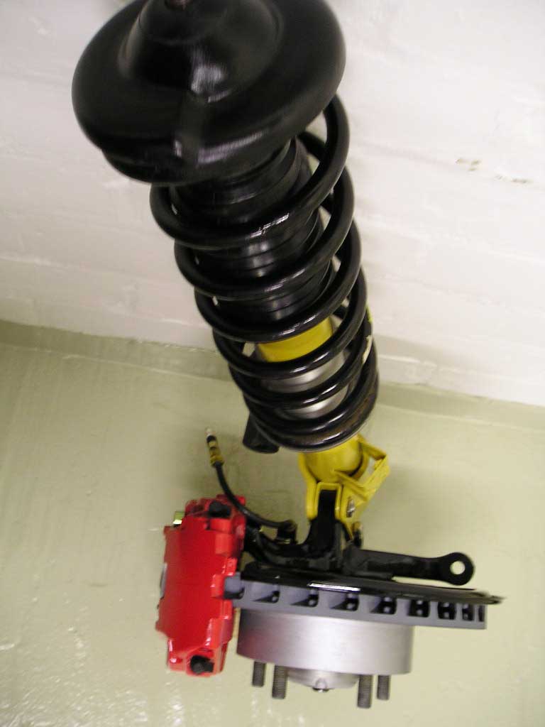

I mentioned a while ago that I'd picked up some Koni adjustables for my 968 Sport which according to the parts list were 944 M474.
Original stickers 951 343 031/032 06 and stamped on the side with number and instructions on adjustment.
Now having stripped down the front, cleaned up, all new bushes and bolts etc have come to assemble the front springs and shocks.
Slight problem in that the bottom spring mount on the shock is about 125mm across but my springs are 105mm across[&:][&:][&:][&:]
Looking at the parts list for pre '89 944s those shocks come up with that part number, but looking at the pics have no mounting plates attached for the brake lines/electrical lines.
But the pics show what looks like a bigger diameter spring and the top spring washer is a different part number to the later 944 & 968. But - think I'm confused now - the top spring washer on the later, '89 on, 944 M030 has the same part number as the earlier 944. Also the 968 M030 top spring washer is the earlier 944 part number.
So do I need the M030 springs from the later 944? Are the M030 springs on the later 944's and 968 M030 a bigger diameter than the normal 944 & 968?
Also which springs to give the right ride height?
My springs at the moment are 32cm length on the bench.
Any help much appreciated.
Dave

I haven't quite followed all the details on this thread, but not all 944's had the same diameter of spring. I replaced the shocks on my S2 with Koni items (the aftermarket ones, not the M474 or M030 ones), and nearly bought some new springs from another 944 enthusiast who was selling them; I was keen to replace the springs as well as the shocks and he had a spare set in his garage.
He measured them for me, and the diameter was wrong, as you said. I never got to the bottom of the reasoning for it, but I think (!) it was an early model vs. late model issue. And it's not much publicised on here.
Suffice it to say that I didn't buy the springs off the member in question, and he was quite decent about the whole thing (I can't remember who it was now - 'hello' if you are reading this.) I seem to recall that he had bought them as part of an offer, or something, and couldn't remember too clearly their provenance.
Oli.
Tom thanks for that. I'll have those please. They are longer but the spring mounting on the shock is lower relative to the stub axle compared to the original so not far out.
I'll try them and if too long will sort it.
You don't happen to have the top spring washers as well do you?
Try and tee up for sunday morning if thats OK. Message me your address again.
Dave
Can't remember the answer Dave - came across this myself, had the same problem with my brothers car c'87 944. Replacement dampers had larger diameter spring seats but we had smaller diameter springs! Back to larger diameter 944 springs and top spring seats! From memory, yes m030 larger spring diameter (larger body diameter also)
