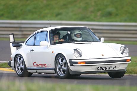

Of course if you really want zero body roll then you are into a whole different ballgame of tbars, sways and shocks. The picture of my car below shows it now starts to lift the inside front and rear wheel off the ground before it rolls more than a couple of degrees. This, of course, has other consequences in terms of suspension travel, ride quality etc.

Great picture of your car Richard - what size wheels/tyres are you running.

The wheels/tyres are 245/45 on 16x9 with 14mm of spacers and 225/45 on 16x7 with a 5mm spacer. There is a lot of -ve camber to run this set-up at this ride height. For every day, I run OE size 225/205 on 7s and 8s with the same spacers to get a little more compliance and ride height.

Got my inside front completely off the ground in this shot. I'm running with the original boge shocks, car 26mm lowered, no strut brace at this point & just a wiff of negative camber, but big wheels / tyres & 26/31mm spacers

PS nice picture Andy - what size tyres do you squeeze on the 17s?
