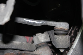

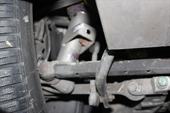

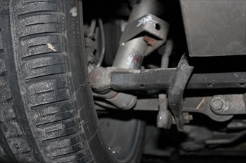

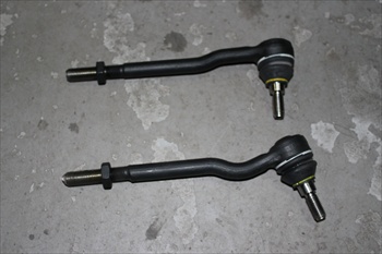

Morning all, Has anybody had issues with kw clubsport suspension spring/strut/monoball assy and using rs anti roll bars, the anti roll bar bracket issue with variant 3 is well documented but the position of the bracket on the clubsport kit (non rs kit)is diffrent and still does not seem to be correct for either a std anti roll bar or a rs one, I attach pics for your perusal!. Also i notice that somebody has fitted gt2 evo steering tie rods and the rs type track rod end to a car which does not have the rs uprights?? I would have thought this was not a good idea?? Maybe the engineer thought that the angle was better than a standard cars track rod end,when running at 10mm below sport ride height (M030/M033) also the adjusting collars on the rear dampers are at the bottom limit and the car is not at rs ride height? |I would have thought that this being the clubsport kit and aimed at the occasional competition user a wider range of height adjustment would have been available. I have not removed the struts to examine the assembly in case somebody has fitted a shim or changed the springs, although visually they appear to be the std kw clubsport (c2) kit ones.
