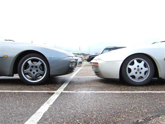

Mine with KW V3 and lowered 30mm nominal (rear TB re-index required)
Its not too low IMHO, approx 75mm at lowest point but it lowers the COG and with decent ARB`s transforms the handling and attitude of the car.
Though I don't think they would extend to standard ride height. 30mm seems to be the nominal drop but no reason why it cant be 20mm say - though you'd still need to re-index the TB's so you'd best be sure you don't want to go lower as you'd need to re-index again. To be honest i've not found a problem with the ride height as it is. I have to take care over speed bumps but other than that I've not had to make any other concessions. I wouldn't fit a front splitter though - it wouldn't last long!
