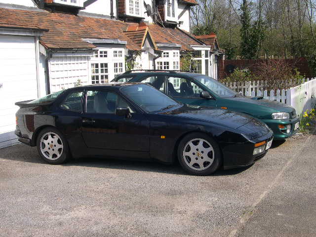

I like your ride height, it looks quite similar to mine
According to the picture the front of Steve's car seems higher than yours, so you may even have the possibility to gain front ground clearance when fitting the KW.
