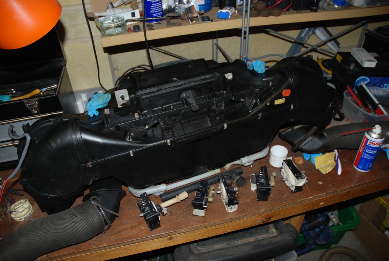

I agree it's likely to be a stuck or worn servo. Here's a picture of my heater unit out for refurbishment. My heating system is/was a disaster so it's time for a rebuild.

The actual matrix itself does not look like it suffers too many failures and is pretty well built. Yo only need to remove it if one of your blower fans fails.
It involved removing the bonnet, fuel tank, fuse box and part of the firewall as well as the radio and the speedo to release a few screws. It took me and a friend 4 hours to strip the unit from the car. You'll also need to disconnect the fuel tank from the fuel pump and so will need axle stands to access the pump from underneath. Make sure you run the fuel to empty :)
