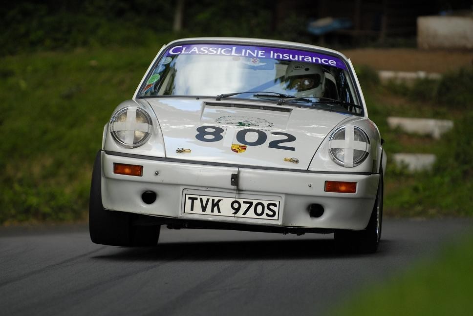

Laura driving gently round Top S at the Classic meeting at Shelsley Walsh. [8|]
Many thanks to Dominic Farley for a couple of superb photos.

Great picture! Trying hard there!

Lifting a front wheel like that usually suggests that it is too soft in roll at the back. Thicker anti-roll bar?
Prepare to lose your money young man! It would need to be a LOT stiffer for Sprints or Circuits, but we've actually softened it to make it faster on the hills, after fitting a heavy Weltmeister rear bar............[8|]
At the event in the photo, both Laura and I set PB's.
