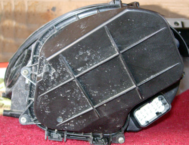

On the 987 it doesn't matter whether you have the std halogens or xenons - its the same procedure - its about 12 minutes to pop each one out, remove the cover , swap the lever over, replace the cover and refit. Hardly convenient in the channel port and much amusemnent to other travellers, and don't drop the headlight unit [:-]
You'll need a smallish cross head screw driver to remove the four screw securing each rear cover too - the one in the toolkit will do but its a bit fat really.
