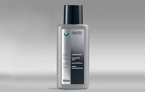

My personal recommendation may seem a little strange as it's a BMW product. My reasons why; It mixes in a bucket of water and is applied with a sponge, will not harm the paintwork (unlike the Porsche aerosol), gives a long lasting and consistent finish ie no patchy areas, and one bottle is good for two applications.
I have tried other products including Porsche's and the Raggtop one but this is the best one by far (May the Great Porsche God in the sky strike me down!!)
Oh sorry the product:
Impregnating agent for convertible soft top, 250ml
