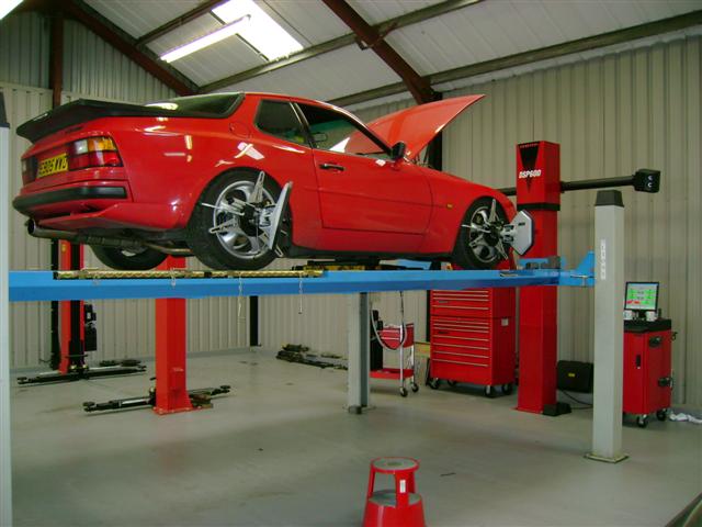

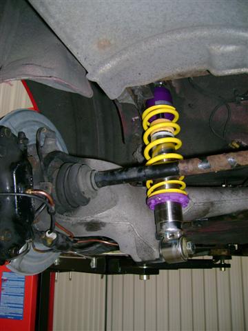

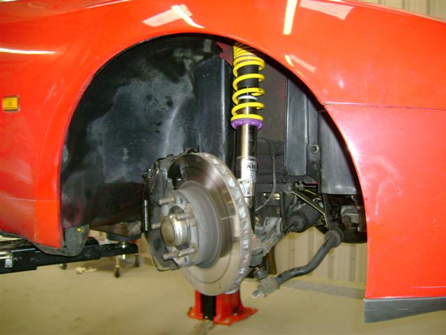

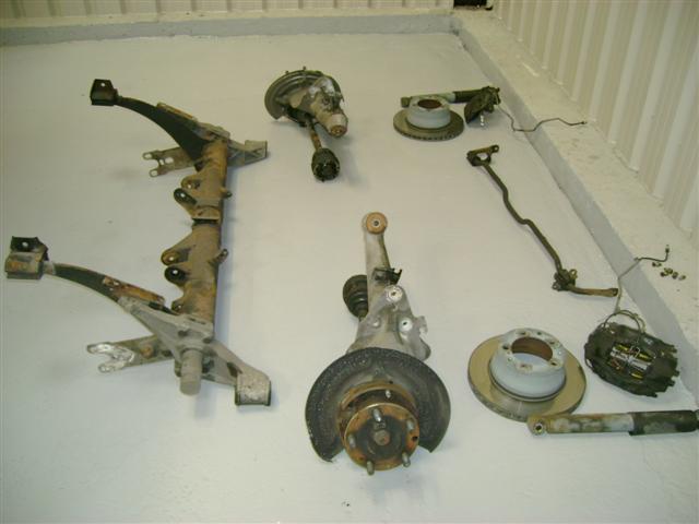

Well after some time the car is nearing the installation of the KW. It was delayed best part of two weeks because the chap in Hartech who is the lower control arm bush wizard was on holiday during the first week the car was in so couldn't start on my wishbones in the first week. The second week was the bank holiday week then he had to source an exchage wishbone to replace my 968 wishbone. The completed control arms were returned to Promax last Friday and they have really pressed on and made ultra-quick progress on the installation. Some photo's below :-
On the alignment machine..... (must learn how to post multiple photo's!!)

Shineeeeeeeey [8D]
Man that looks slammed! My poor car looks like a 4x4 compared to all these lowered cars
Well aparently the rear of my car was quite low anyway and Andy reckoned it wouldn't need lowering much over what it was before. I had always thought it looked lower at the back. It had one side at the rear drop in the cars past and the TB's re-indexed so maybe they reindexed the higher side to suit the dropped side. Obviously the front was not lowered as the struts were not height adjustable and I had the standard springs with the grey dots so the car was at a nose-up attitude.
