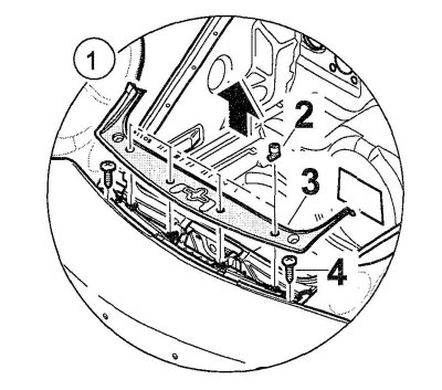

There is no separate fuse for the luggage compartment light. It's most likely to be the microswitch on the latch - under the panel here:

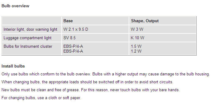

aha.....I've actually checked mine and know why its not working....theres no bulb [8|]
can anyone tell me what type it is please ?
