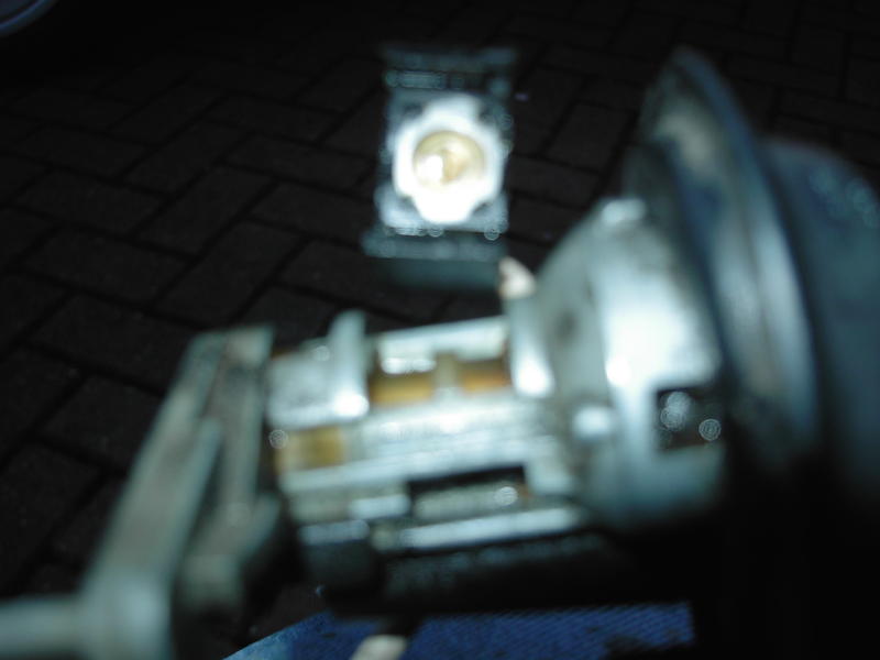

Out of interest did you sort the locking problem you had... was it the micro swicthes... I'm asking beacause I have lived with my passenger side door not operating the central locking, which I believe is down to an issue with the switch, but removing the handle and having a quick look, I didn't fully understand how the switch fixed to the handle... So I just put it back together and carried on fixing my electric window...
The switch just clipson to the handle, it can be prized using a screwdriver and the cable is held in place with a small clamp.
Apparently, you use a small screwdriver to carefully pry the microswitch off the lock mechanism (so says Bentley). 'Installation is the reverse of removal', as they say.

No, it really is as easy as it sounds for a change, it just snaps back into position. I've got a spare switch in the garage, I'll post a piccie of it when I get the chance. It will all become clear then!
OK... Taken the door to pieces again... and it is the micro swicth on my car which is stopping the passanger lock from operating teh central locking,... The little switch peg, is just broken...
so door now staying in bits until I get a new one... any ideas on price and availability... I can't find them on line, so am going to have to wait until I can ring round tomorrow...
Try Simon Butterworth at Porsch-a-part, I think I paid about £20 off the top of my head for a second hand one. A new one from the OPC was IRO £60!!
BTW, the 'actuation finger' on the switch is nothing more than a little ridge 2mm high!!
