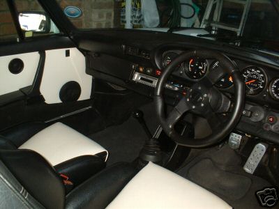

The engine has had a rebuild and the gearbox was refurbed about 15000mls ago. Can you still use a 911 ok when the heat exchagers need replacing as the summer months role on I wont be using the heater and I will be taking her off the road in the winter so I thought I could replace them then, incidently I would be interested in the ones you will have for sale later in the year so keep me in mind for those, I have attached a couple of photos, not great ones but see what you think.
Nick
Car looks nice. But as john says check for rust. The heat exchangers are a sleeve that fits over the exhaust pipe to heat the inside of the car. As long as the exhaust pipe itself is not rotten and leaking it would not be a problem to leave till later. There is a complete stainless exhaust on E-bay at the moment 2 X heat exchangers plus a back box to suit but it will mean altering your oil lines to clear. I found good second hand heat exchangers for the right price, they are about. Mine had a stainless back box on it when I got it and I have added a stainless pre-silencer since. When I fitted the hewat exchangers I fittedit with stainless cap heads much easier. Good luck with the car.
Barry
Nick, have to be honest, the Miami Vice seats aren't my cup of tea and neither are the drilled pedals, but that is a good price if the body is OK. Get it PPI'd and if you get the green light from that then buy it. If not then knock it down a few quid and then buy it, looks rather nice and has had some good work done by the sounds of it. Have you driven the car? How does the gearbox feel - snatchy changes or is it all nice and progressive? Did they change the clutch when they rebuilt the box? Anything else strike you on the test drive apart from how bloody wonderful SC's are? [8D]

PS: Do you know what size the Fuchs are? Obviously 16's and looks like 7's in the front but then looks too tucked under to be 8's on the back - send us some more pics! If they are 7's and 8's then you have got some sexy wheels there, 8's are hard to find and worth an easy £350, though if they're 6's and 7's they still look good obviously.
