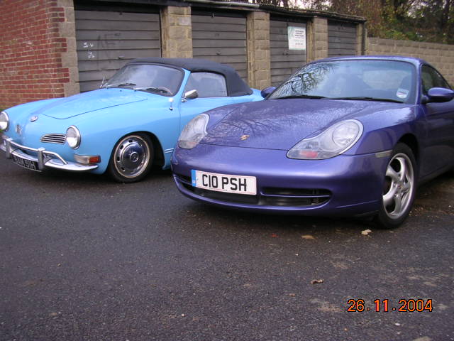

I am advertising my carrera 2 in the next couple of weeks. December 1998 car, Zenith Blue , black ruffled interior, 3 spoke steering wheel, small alloy pack, embossed headrests, CDR 22 with 6 cd changer, clear lights, stainless door entry sills, Porsche service history with current porsche extended warranty until dec 06. Recent 12K service at porsche tonbridge - also had new clutch fitted and RMS. 68K miles. good tyres on 17" turbo look rims. very good condition inside and out. looking around the 25K mark. Car is in Kent.
Plus - Tracker fitted, Climate control, Rear wiper.
This is the only one small enough at present - will post some more in a couple of days
