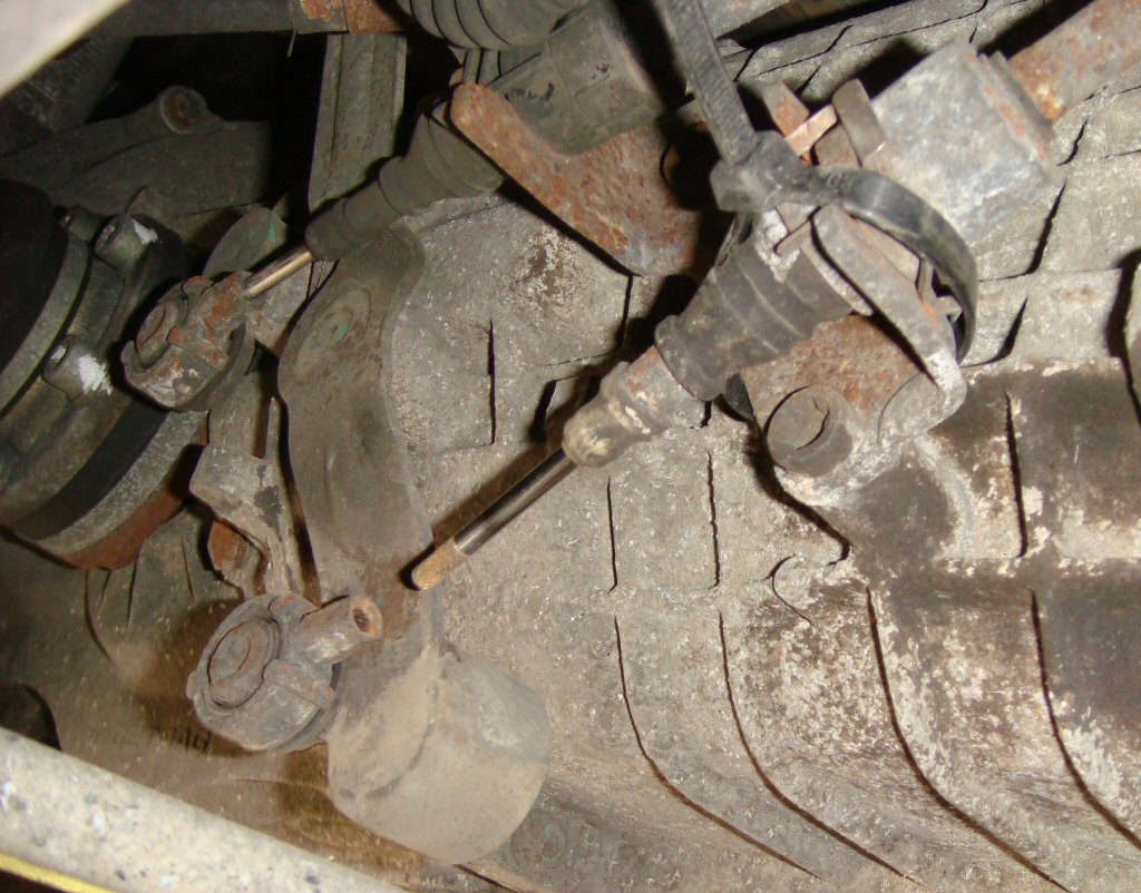

Just to show you that you aren't alone in this experience, here is a photo of another broken one, which is what I expect happened to yours:

On another front, i noticed from your picture that there seems to be other connectors. Does the cable assembly do all gears or are the cable assemblies for seperate gears, ie are there five fitted?
What im really trying to find out is whether this issue could occur again for a particular gear or whether the problem has been completely resolved,
many thanks.
There are only two large cables in the assembly, which goes from the bottom of the shift mechanism, and attach to two arms on the transmission as per the photo. The most common problem is that the plastic clips holding the cable sleeve end to the bracket on the box break, causing the same effect as a broken cable. The common fix is also shown in the photo - a cable tie!
