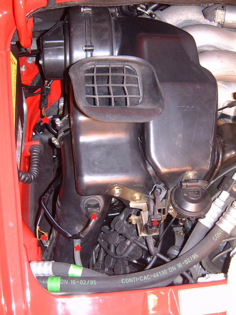

I need a bit of help with a loose tube i have in the engine bay please.
On the attached picture there is a tube with a star (lowest one) marked. This is attached as in the picture but is loose at the other end. Please could you tell me where it goes as i am new to 993's. A picture would be most welcome, please send to thenewmans2009@hotmail.co.uk

That's the tube that connects the heater pipe to the distributor housing. It's function is to allow air to flow into the distributor casing to prevent the build up of "ions" which can cause the rubber drive belt to break.
Early 964s had the same dual distributor arrangement, but without the tube, with the result that the connecting belt would sometimes snap, often without the owner realising, causing serious engine damage.
Not wishing to worry you, but, it should never have been disconnected, and it is very important that you re-connect it as soon as possible.

In your photograph, you can actually see the other end of the tube. It's meant to push-connect over a solid pipe which comes out of the distributor housing below the black plug.
You can see it just below where the '02/95' is printed on the hose to the right of the image.

Thanks guys i found the hole in the distributor an the tube is back were it belongs. Next i need to see if rear reflector is height adjustable. Clyde thinks that it is not but there are three long bolts in the top which make me think it might be. Please confirm or deny this for me oh learned 993 ones.
