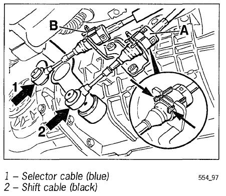

Unfortunately, you can only buy a complete cable assembly. It looks like this at the rear end:
Thanks Richard ... will jack up the back & take a look. Earlier I couldnt see which side it was on, but with it jacked up I am sure I will be able to see what is going on.
Cheers, Jason [:D]
