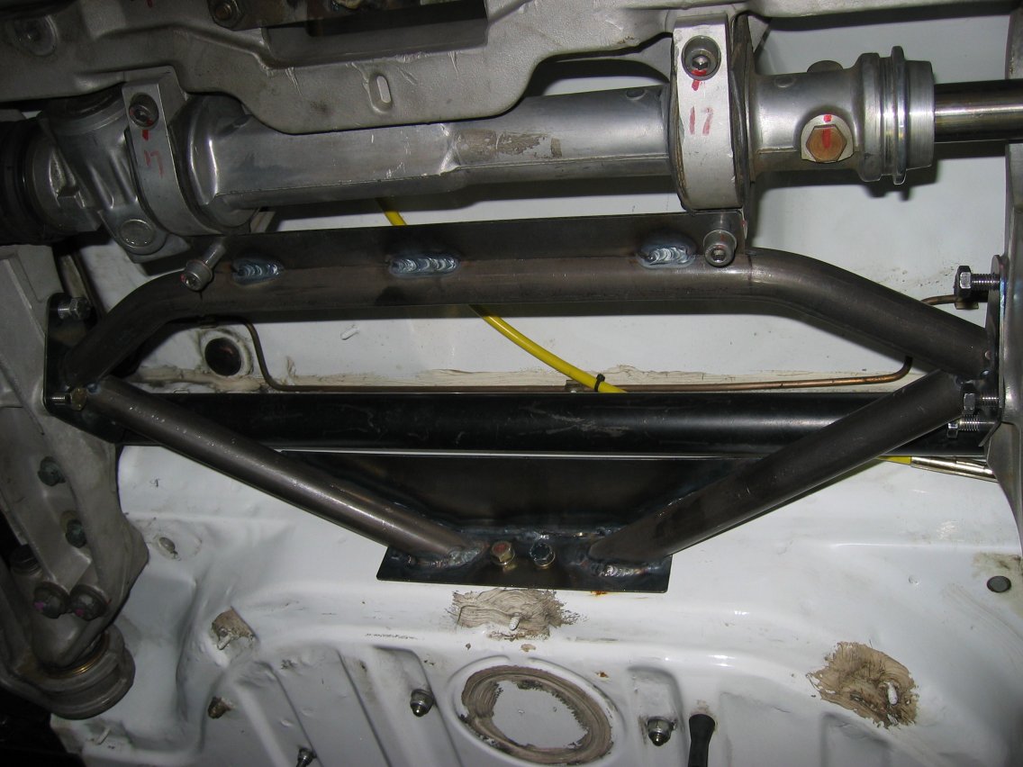

Today's job was to fit the 993 steering rack brace upgrade for running 18" wheels on a 964rs.
I did a bit of research on PelicanParts and Rennlist and came across a few threads talking about the hassle of fitting the bracket in between all the tubes and pipes up there...
...well, not on the K.I.S.S. lhd RS there isn't... [
Also, while fitting the bracket my 12 yr old nephew who's staying with us for Easter popped his head under the car, had a look around and said, "It looks just like a toy car." I wondered what he meant. "You know, when you turn your toy cars over and they're just smooth and flat underneath." [
