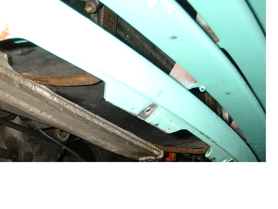

I'm intrigued about this intercooler of yours? Is it a standard one, but lowered, or is it a custom build?
The standard intercooler has inlet and outlet clearly visible at the top of it.
Good to hear that it was something simple and free, rather than complex and expensive [:D]
Standard and lowered........... up side down and back to front IIRC
No Aircon to get in the way.
Mike[:'(]
Are you sure? I can't imagine why anyone would run a standard one back to front as the inlet and outlet would face forward and need a 180 degree bend to get back to the turbo outlet and throttle body, which would make the pipes longer than necessary when you want them short. Then again did you say at Oulton it is in front of the rad in which case the connections would have to go forward or through, which might not be a great idea for the coolant...[FONT=verdana,geneva"] [FONT=verdana,geneva"]If that is the case then surely the standard position would be better?[FONT=verdana,geneva"]
Here it is, on the home made rusty brackets!
