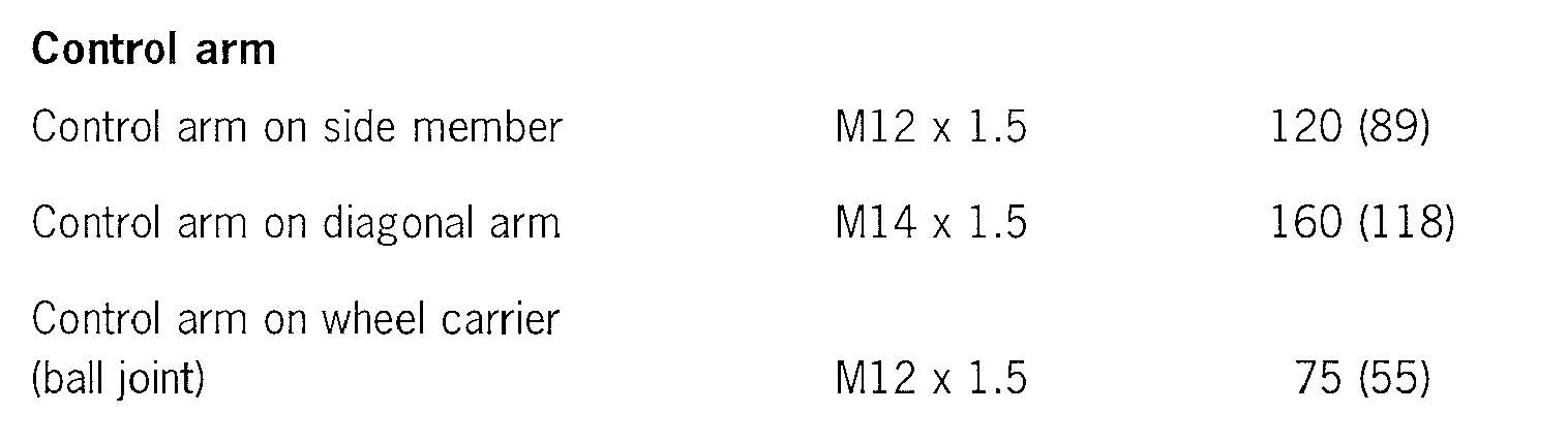

Does anyone have the torque settings for " E " in the diagram? I have a creaking ball joint on the control arm and I am going to attempt to replace it myself.
The car is due for its annual service in February so I will get work done close to the service and the alignment checked then. But in the meantime if anyone has the settings I would be grateful if they could share them with me.
TIA
