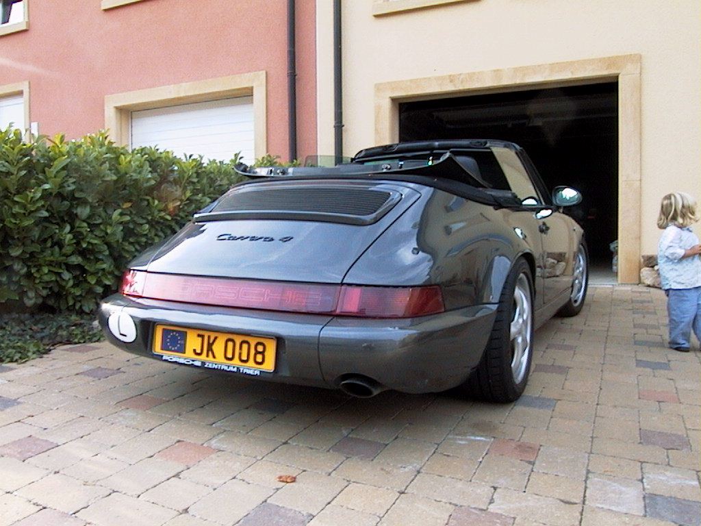

Anyone how i can get the roof down? Since i took the engine out the roof will not come down? I can hear the relay click! Any ideas?
I need to remove the roof to repair the rear wing?
Mine was sticking a while back and then stopped while half open......turned out to be just a fuse, easy to find in the labelled fuse box, under the bonnet, right hand side by the skuttle panel (though mine's a LHD car).
Check this first........good luck.
