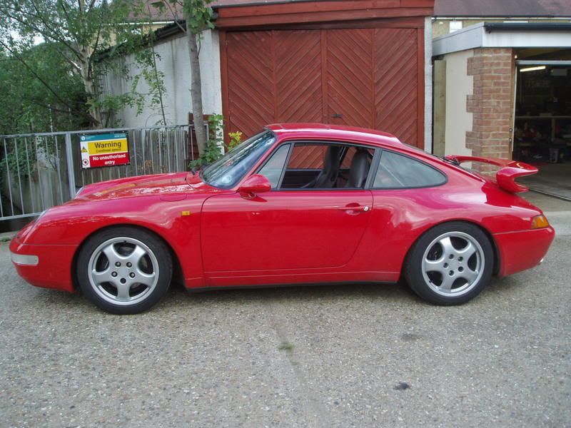

I have Billy HD and H&R and 18s and they do not touch at all, but bump-steer is chronic - can not drive in slow lane of M6 at all because of the tracks in the road from the constant lorries. I have to drive in the fast lane all the time which means going fast, unfortunately.
i got a 1997 c2 coupe on 17`s which at some point i was going for an upgrade,
would these shocks & springs you have on your red one be ok for mine ?
if so do you have part nos of all needed & where from, best place to buy from ?
& what sort of cost is it all ?
