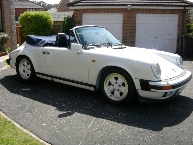

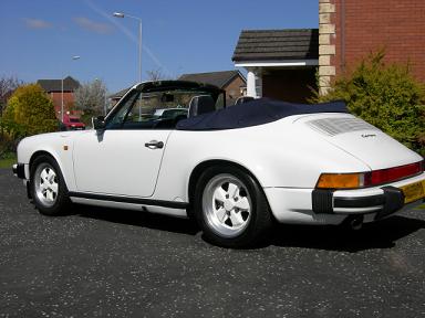

This is my cab lowered to CS spec by 9M
It does make the ride less compliant but the steering weight is fine. Dont get too much neg camber put on as it makes the car v twichy. Makes the car kinda speedstery look.
