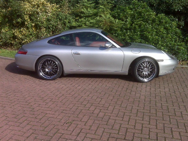

I would like to lower my car but not sure how much of an affect this has on the balance car. I am looking to lower it by 30mm rather than putting a kit on it. Hopefully it will help the floating at speed issue. Can anyone advise for or against doing it?
I have a 1998 C2 tip.
Lowering it won't help the "floaty at speed" feeling on its own. Are you sure your geo has been done properly? I would take the car to Chris Franklin at Center Gravity for a full geo before doing any other suspension work.
It did have a full geo done by Parr after the lower wishbones were replaced in 06. I have had the car since summer last year and at that point the car had done 3k since the geo. Since then the car has done 10k and has always been floaty. Having the bigger wheels has helped keep it more planted.
