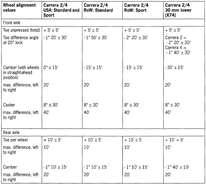

I am thinking of lowering my C2 with some Techart 30mm springs. Should I also have the geometery checked at the same time?
Steve
Just fitting the springs will mean that the geometry will be disturbed, so you definitely need to get it reset after fitting. I'm not sure what settings you should use though, if you aren't changing the anti-roll bars or dampers. I would have thought that the M030 or X74 settings would be the ones to go for, but the spring supplier might be able to give you the correct settings.
