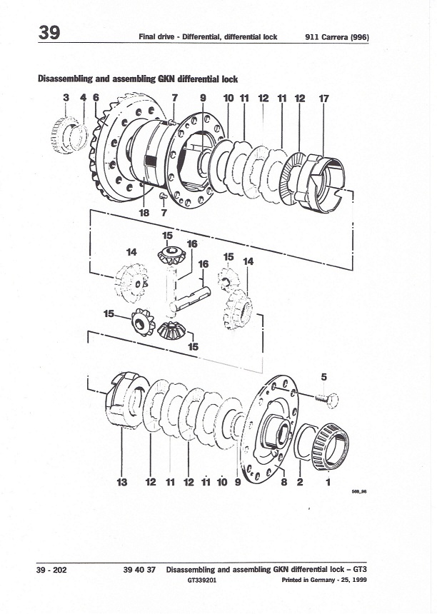

Hi, does anybody possibly have a drawing/parts list for the LSD which is put into 996's that have PSM, i think it was just the anniversary model but there maybe others. This particular incarnation of this diff has just the one friction plate in it....
thanks in advance

I've hunted high and low in the stuff I have, and can't find anything. I think it is because they don't supply any spare parts - only the complete assembly. Even the GT3 Cup is only available as an assembly, and there is nothing in the service manual about it. If you could find out who makes it, you might be able to get some info from them.
Thanks for looking richard, i've managed to find this and its items 10,11 and 12 which i need, proving hard to come by though, maybe somebody has some on here??
