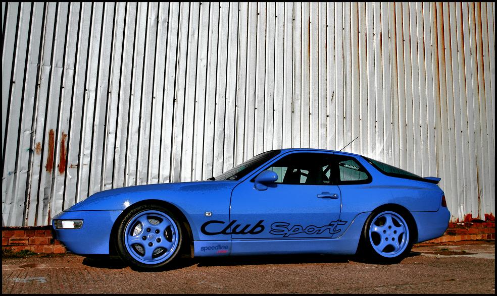

For those with M030 (968 with rear helper springs) what rough ride height are you getting to the bottom of the arch?
My latest toy has complete M030 kit and it is bugging me that it rides quite high at the back, some c655mm to the bottom of the arch.
The problem is the dampers/springs. It has genuine M030 dampers which are the same length as standard non-M030 dampers (which incidentally sag when weight on them and thus reducing rear ride height) and correct barrel shaped helper springs. Problem is, these M030 dampers/springs dont particularly sag with weight on them making the car quite high. It does not matter how much you adjust the height on the spring plates or torsion bars, the M030 dampers and springs are dictating the overall height! They are adusted to quite a hard setting, maybe this makes a difference?
I have gone as far as adjusting the spring plates to play around - currently one is on full 'high' and the other side full 'low' and it makes no difference at all. The M030 cars have a different spring plate angle via the torsions (9 degrees for the M030 against 14 degrees for the non-M030 cars (taken from the flat part at the top of the torsion tube 'banana' arm that protrudes up into the rear arch for those that are interested) but i can't see much point, it just alters the point at which the torsion bars become 'active' - later in the barrel helper spring compression - and appears not to alter height due to the dampers/springs!
