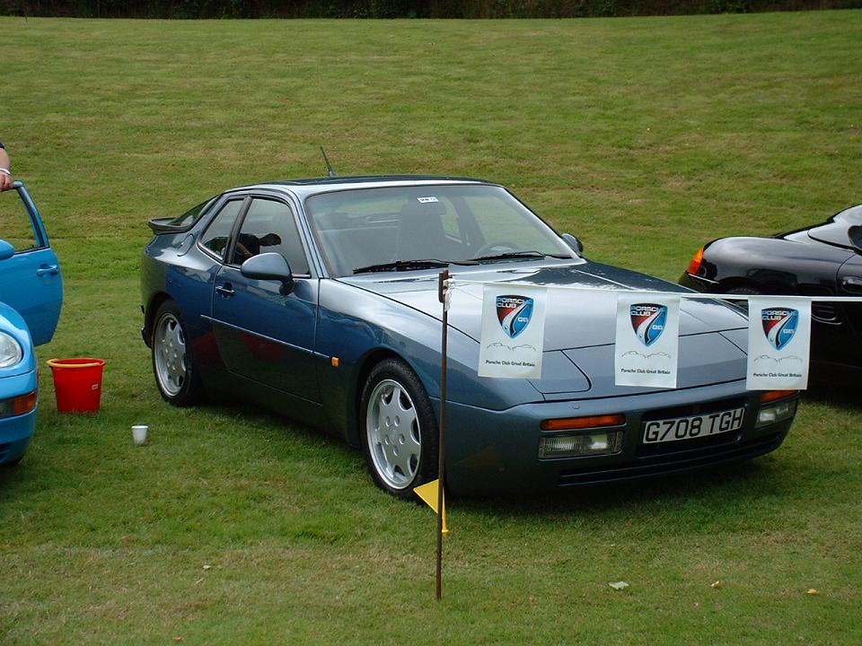

Fen, did you have to adjust the rear ride height when you used 968cs springs on your S2? My car sits a bit lower on the back at the mo anyway, so hopefully it would sit level with the front lowerd a little, or there might be some adjustment in the rear spring plate eccentric bolt.

Yes, I had the rear lowered, but did it need to be? I don't know. I had it adjusted as low as it would go without re-indexing the torsion bar.
Albeit that it had 18's on , here is how it sat:
http://images.fotopic.net/?id=622161&outx=600&oq=0
I have a picture at home of it on D90's I can dig out if you want to see it.

that looks really nice, I guess I'll just have to wait and see how it sits when I finnally get round to doing it all, and decide if the rear is too high.
I've read that adjusting the spring plates at the back is quite an easy job so we'll see[8D]

Here's a pic of my old S2 on D90s (Turbo 9" on the back and S2 rear 8" ones on the front) taken after I'd sold it at the Devon & Cornwall concourse in 2001. It lives in Denmark now I believe.
