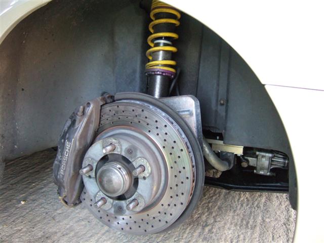

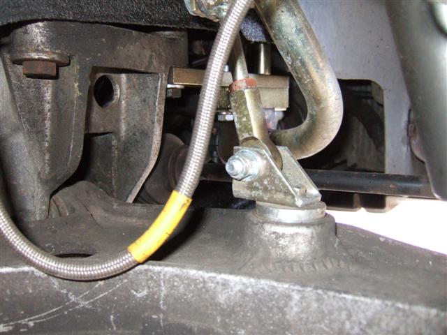

What Fen said. I cannot stress how good the KWV3 and W/M ARB`s are, awesome, chalk and cheese.
Here`a piccy of the mahoosive (adjustable) w/m front arb with the KW V3 front strut
More piccies upon request.
Heavy looking ARB, is it hollow tube or solid?
Who did your align/setup/corner weighting?

Thanks for the images
